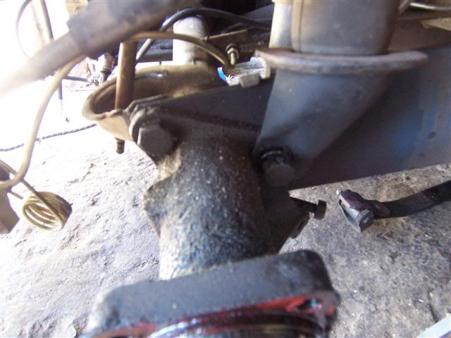

Managed to get both the new spring plates on and got the straight axle gearbox in.
Can someone please show me what the nuts/bolts look like that I need and where I will be able to get them

Those should be normal High Tensile bolts and spring washers available at Fastener Warehouse behind Ranch Meat Supply
- Posts: 15008
Re: 67 Panelvan
does this help?

Yes !! Great will get some tomorow, what are they torqued to ?

Gearbox drain plug are sometimes very stubborn to remove
A 17mm allen socket and a power bar does the trick
and Remember lefty loosy righty tighty
as you are upside down
The side bolts just gets tighten nice tight
