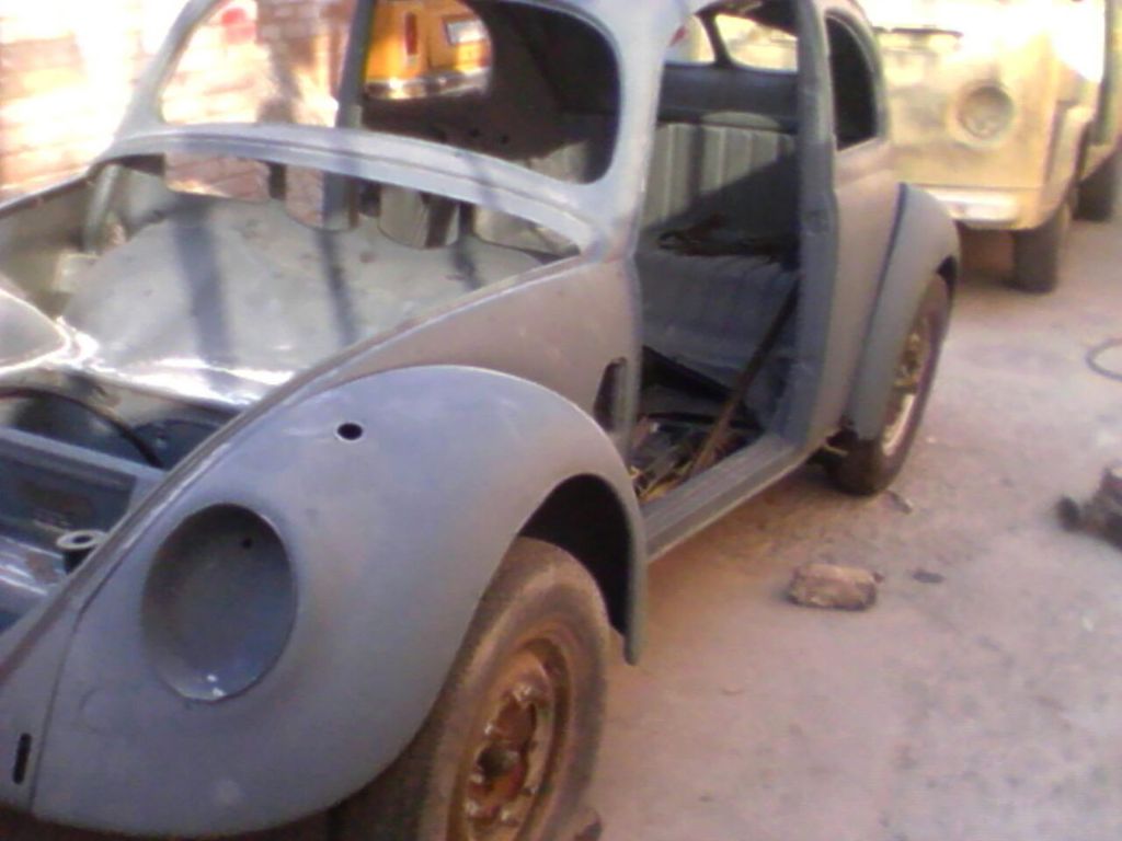

This means, that to prevent the 1952 Beetle project from grinding to a halt, I have farmed-out the Body work, or should I say, the metal cut, bend, fit and re-weld to someone with more time and better equipped for the job.
No, the final prep and flatting will still be mine, and the body ready for paint will be done by me.
Then Paint and assembly..... again ME....
So here are some teasers to wet your pallet.......

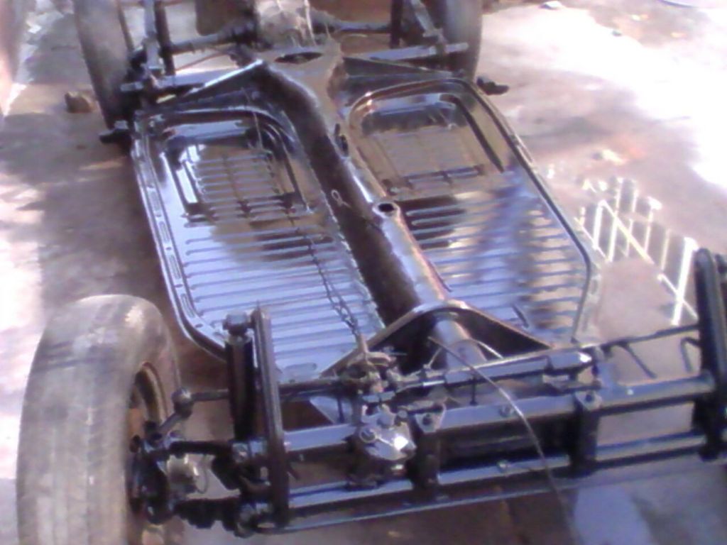

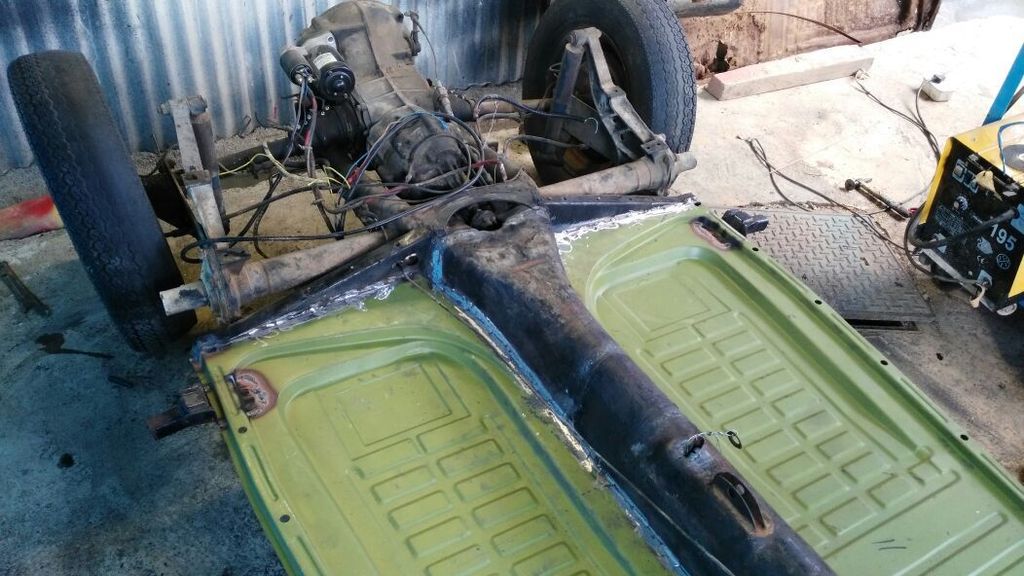

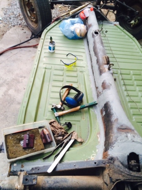

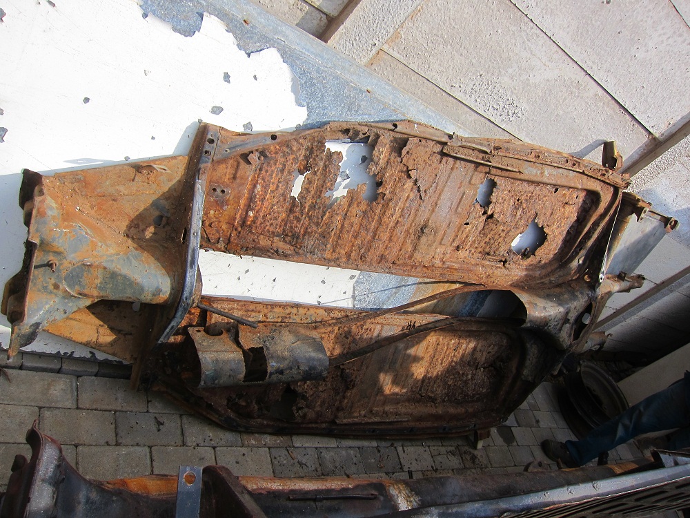

Here we have an Hole'y 1952 Beetle pan with more hole and less pan.
As this is the correct pan for the car, we will have to fix it, and get it back to life....
and that has been done.....

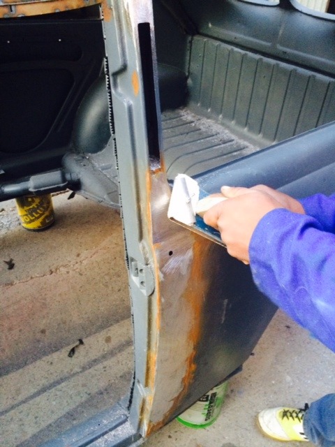

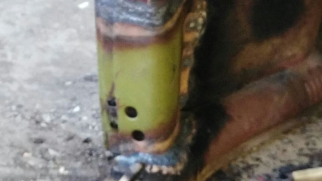

"A" pillars are gone "west"as well, so they where cut and fitted.......

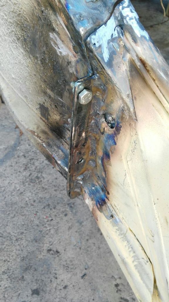

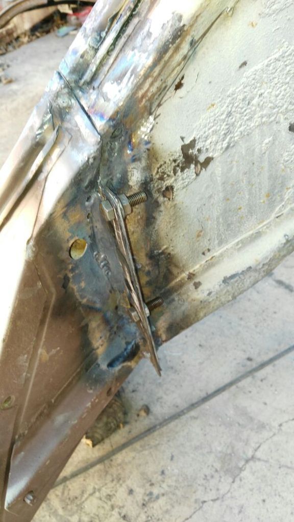

As some of you may remember, this will be a "Used" car, not a Trailer Queen, so the engine will be "Upped" a bit, and to load it in and out with ease, the back Valance has been made removable.
With all shouting at the same time...".Beetle engine is easy to take in and out.".. let me explain..
The split window had a much higher fitting engine, the box is held tight up to the body, so to get an 1600tp engine with twin carbs in is near impossible. Yes..Yes.. if you take off near all the satellite parts, it just slips in....but fully complete, its a drag.

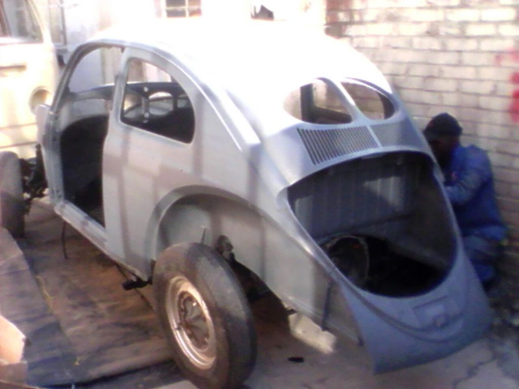

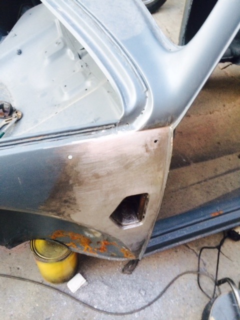

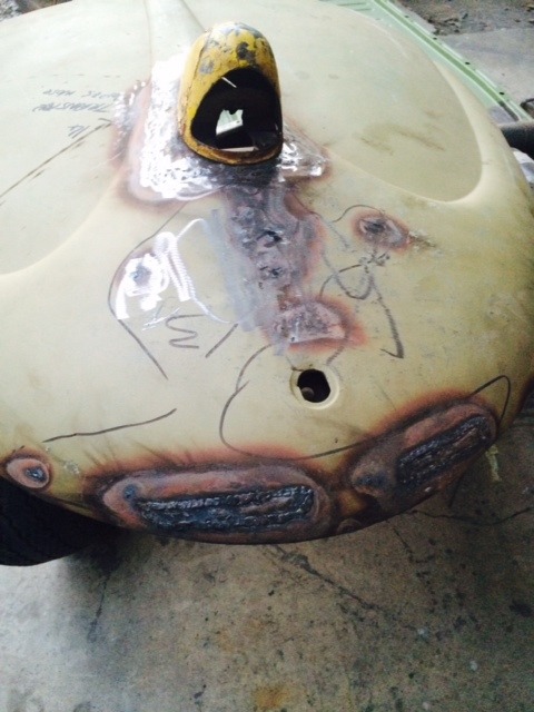

Ok , so the work is going on.
The metal is being replaced where possible, and the other areas are being welded up, with new steel.
The Pope Now has a nose again, bit worse for wear, but a nose all the same.
The pan has just got to be cleaned up and smoothed out, to ready it for the epoxy coat coating.
The bumps are being leaded out, to reduce the use of filler, something the old 52 Beetles had little of.
The body is coming together nicely, so soon we will be having it back in PE for the paint prep work.
Thanks for looking.

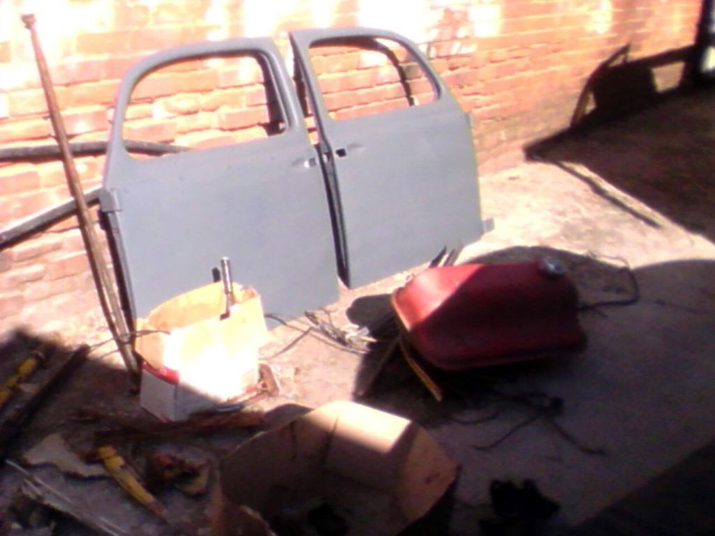

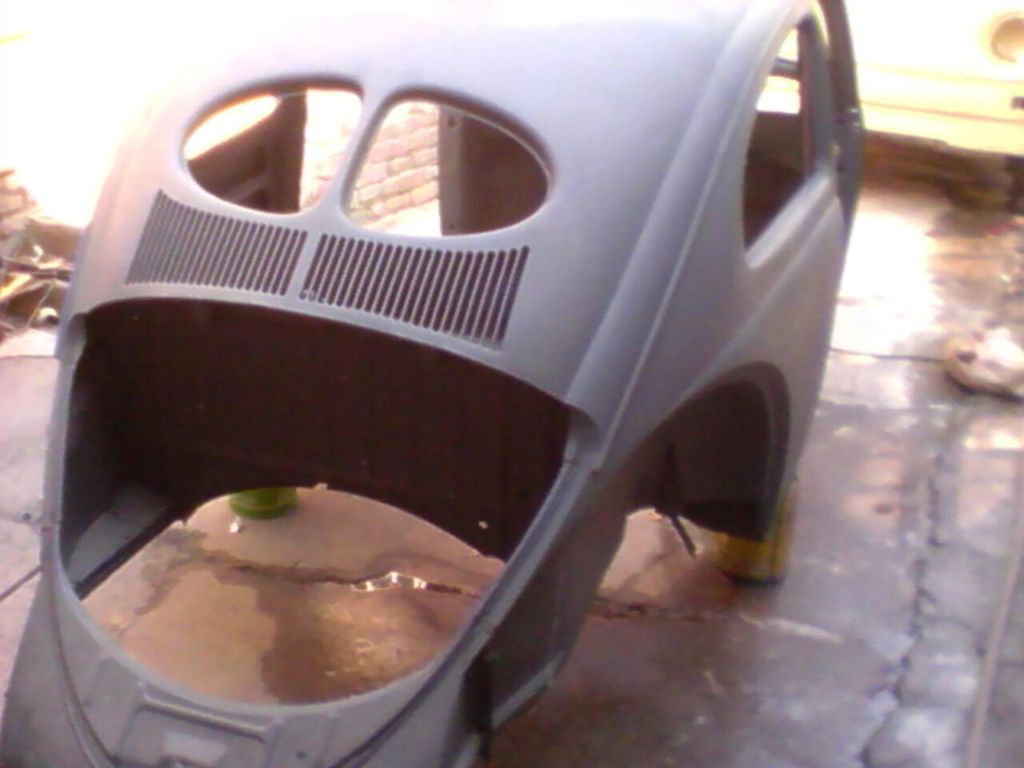

Well the body work is coming on nicely now, and she is near ready to come home.
Will just be light bolt on of all the parts, so that It is easily striped here at home, to start flatting and readying the body for paint.
Will be removing the body off the pan, and building the car up from there.
OK, Here is "before and after"
Looks a bit different to when she was found.
Well, this is a start of a new beginning for her, and a joy to have a 1952 in a 1952, and one is as good as new....... :lol:
