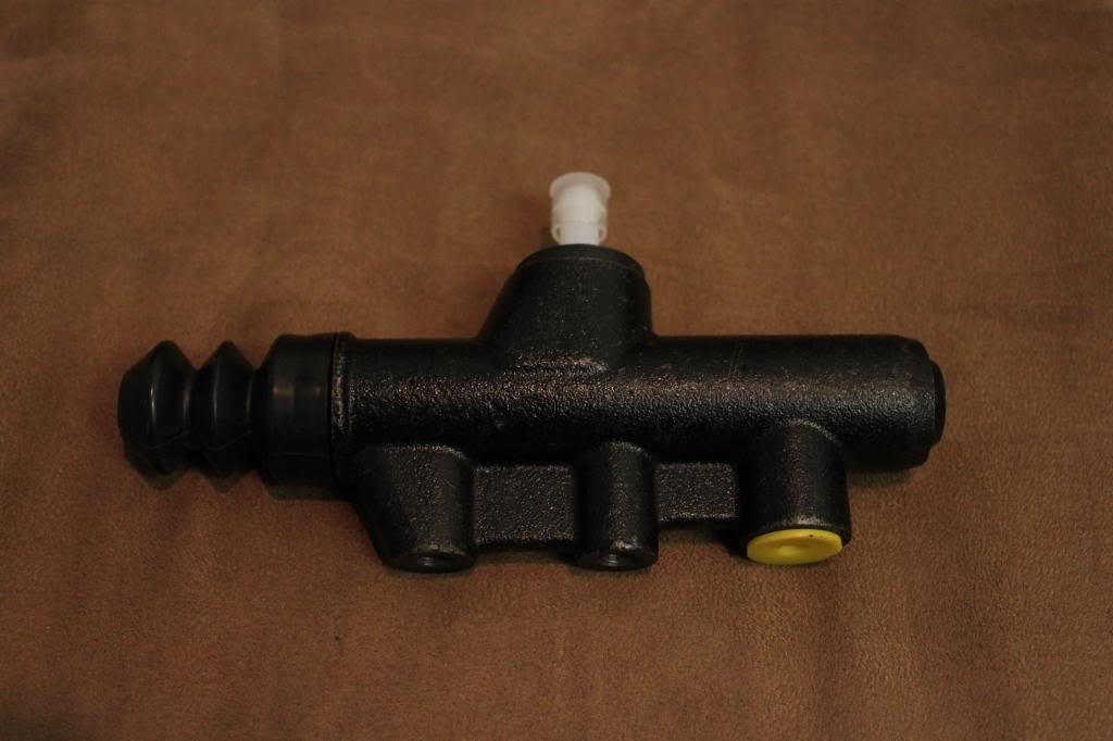

Thanks Rui , I do know about the Empi slave but there is no master (empi) that would be compatible with the bus clutch pedal setup, there is a master from Wilwood but again import . My issue is not as much the "stifness" of the pedal as it is more a fear that the cable might not be able to handle the extra stress from the upgrade p/plate. I have just pulled a master and slave from stock for the micro busses and this seems to be a viable option with minor mods the added benefit is that the cylinders are still available locally in the event that there is a failure.I will take some pics of the cylinders and share my thoughts on the fitment.

a thought that I have had which has not gone any further... couldnt you use the stock cable to actuate a remote master cylinder, which then operates the slave cylinder?

Thanks James that looks like a leka cylinder I will def consider that if the T3 cylinder does not work. :hangloose:

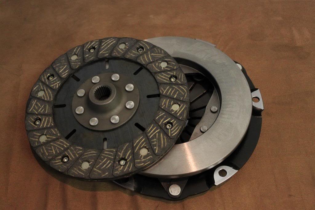

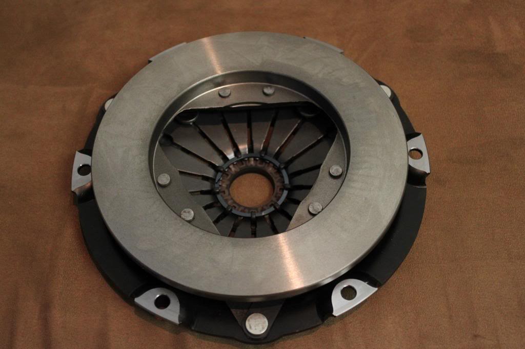

Oh im so happy thanks Eddy for all the help and effort !
Its here : . KENNEDY 200MM CLUTCH PLATE STAGE-II WITH REMOVABLE T-O BRG COLLAR -
HI-PERFORMANCE CUSHION LOCK CLUTCH DISC - 200MM
HEAVY DUTY BILLET REPLACEMENT CLUTCH SLAVE CYLINDER
And the T3 master im hoping to use.

Don,t forget to remove the collar from the PP otherwise motor is not going to go in. Get the FW & PP balanced again, if there is one thing that is the most out of ballance it's the PP.
