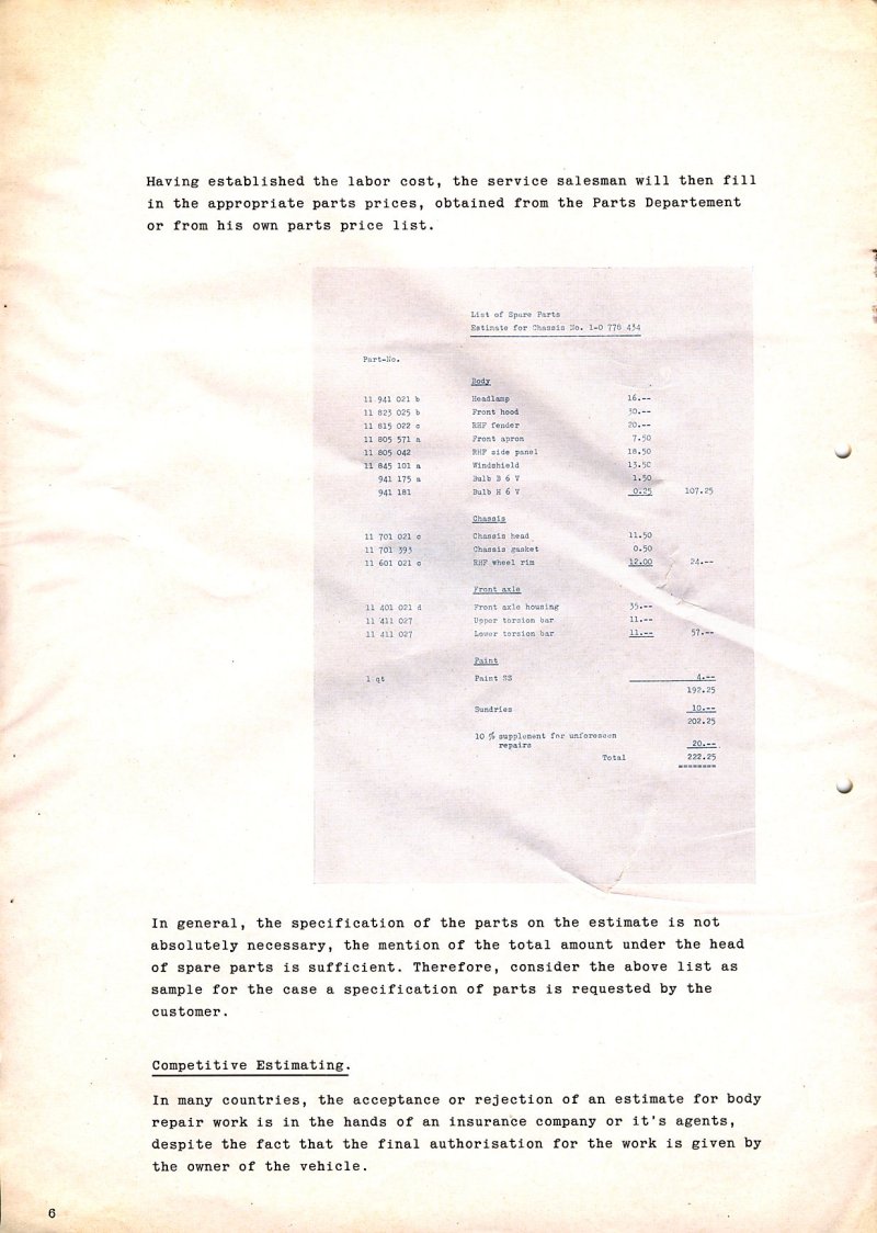

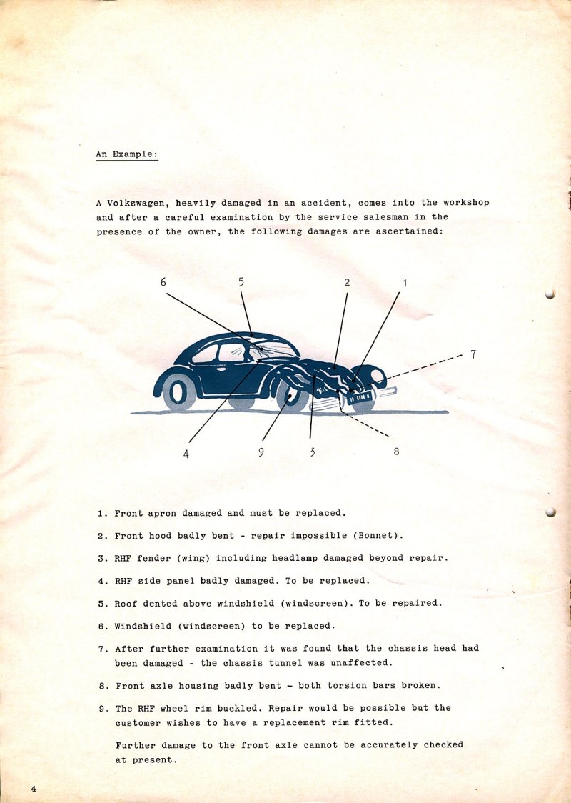

Interesting 1955 VW service bulletin with some nice artwork
