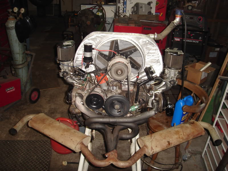

Came across this picture. Must say, i'm not a watercooled guy at all, but this guy has an interesting idea. He taps all four corners of the heads for better waterflow. System is self-bleeding, as hot water and air-bubbles rises to the top. Nicely thought out.
I would change the fan from a suck-through to a blow-through, and let the used hot air exit over the transaxle. Image

Wow, this is BRILLIANT!
Any other pictures, or even the website/thread where this machine was built?

Now that is one of the best ideas for a radiator I have ever seen. Spray the cowling black and most people will think it is a Type 1 engine if they open the engine lid. :hangloose:

Found that on the Shoptalk-forums.

Thanks, I will be heading over there.....
Just in case, can you post the link?
Thanks!
(Did I mention how much I like that idea?? :shock: :hangloose: )

Must admit I like this idea as well :idea:
